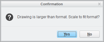

I have a dxf file created in autocad drawing, when i am trying to import it creo 3, the file scales itself to larger value.how can i open it in the same scale.?

You can create a blank creo drawing of your choice of size and then insert/import the dxf into it.
You will receive a confirmation to change the scale to fit your format. if you select yes then the DXF will properly fit into your drawing template.
