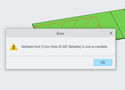

I have a problem to bring the ECAD/MACAD collaboration to work.
The compare/validate Tool in ECAD/MACD Collaboration runs always in an error (see picture)

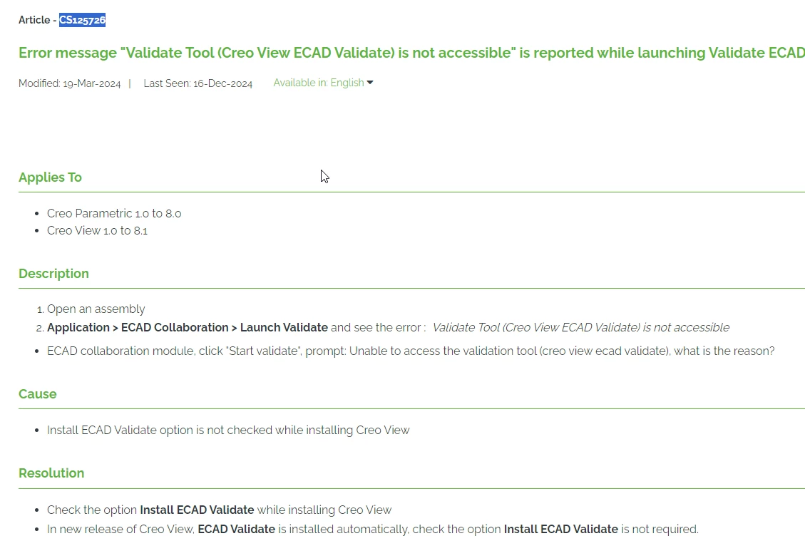

I found the following support articel (CS125726)
and reinstalled, as adviced there,  Creo View.  But no success - compare Toll still shows the error massage.

Dec 18, 2024 5:28 PM UTC
You need a special Creo View license to use this functionality.
license 267 - PVCompare_proe_cl
