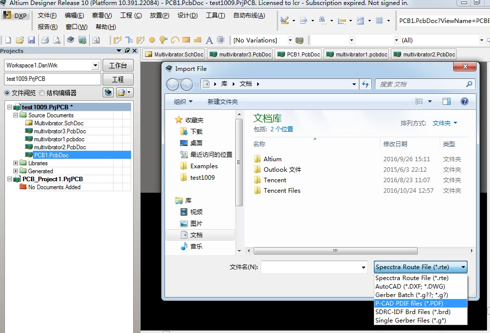

I am currently working on the ECAD-MCAD collaboration with incrementel IDX-File. We use Creo3.0 for the MCAD department and AD10(Altium Designer Release 10) for the ECAD.
My question is "How to import  the IDX-File into AD10".
I can't find the command of import idx-file  in the AD10.
Would be glad if someone faced same problem or see the solution.

To use IDX files you must have a dedicated license on both SW (Creo and Altium).
Marco

You mean there are professional and non-professional versions in AD10?
