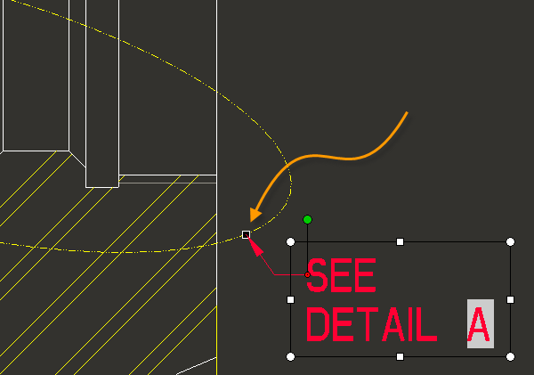

On a non-circular detail view label, I have to use "edit attachment" to move the arrow placement.
Is there something I'm missing? It's an annoyance that frustrates me to no end.
The little black grab handle is there, it looks like you can grab and move the attachment, but you can't. You have to right mouse on the leader, edit attachment.

Historically, before handles and graphical manipulation, you needed to enter a command of some sort to say what you wanted to do.  Because the leader does not need to be attached normal to a circle, we had two distinct actions:  Move the note, and move the arrow point.  These got handled by the commands Move and Move Attach respectively.  The graphical manipulation handle on the arrow point sounds to me like it ought to be able to move the attachment.  My guess is that we didn't contemplate this case specifically when making the new UI, and the code that generically works on leaders to edges/surfaces/axis-lines/datum-curves/draft-entities/etc/etc does not happen to work on this case.
I don't think you need a Product Idea here.  I would recommend filing an SPR, that dragging the box at the arrow point on this note ought to be able to move the attach point.

Update on this:  you'll need to put up with the workaround for a bit longer, as we missed the cutoff for M140, but you can look forward to it in M150.
