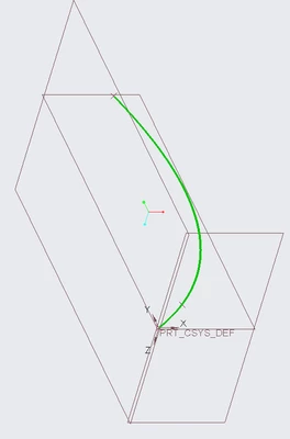

Apr 4, 2023 1:19 PM UTC
I tested trail method successfully.
Situation no.1
! DATUM POINT ARRAY DATA FILE
! Comment lines should begin with an exclamation mark (!).
! You may have as many comment lines as you wish.
! There must be at least one space between values.
! Enter values with respect to datum arrays' coordinate system:
!CARTESIAN coordinates:
! X Y Z
 0.00 0.00 0.00
 10.00 10.00 0.00
 20.00 100.00 0.00

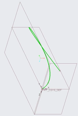

Situation no.2
! X Y Z
 0.00 0.00 0.00
 10.00 10.00 0.00
 20.00 100.00 0.00
 30.00 30.00 0.00
To be able to do this change, following trail file has to be generated and replayed.
