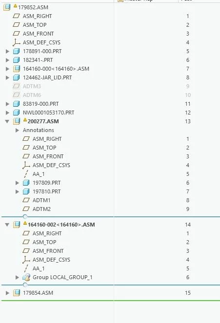

"Edit Definition" option not available for parts of assembly
Using Creo 8.0 and WC 12.
I have an assy that was created a while ago.
Some parts and sub assys are editable, but some are not.
Any suggestions on the subject?

So, after a lot of guessing, I found out that the questionable assy had a family members and those members that I was not able to edit definition were defined on the family member level/ When switched to an instant level assy, edit definition function was available. Thanks you.

Not enough information for an informed answer.  Can you provide a screen shot of the issue including the tree?
My best guess from given description - Are the parts read only features?
Oct 13, 2022 6:56 PM UTC
sub assy that have a yellow triangle ( outdated placement) does not have "edit..." function, so as one part on top of the firsy sub assy.

So there are 14 members of that assy, subassy and parts. 2 subassy and one part are not editable, while the rest of them are...
