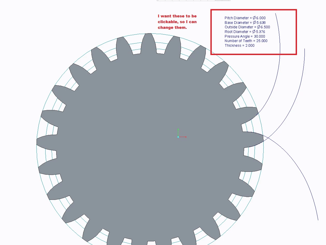

I have setup a gear within creo and displayed the editable parameters as annotation. The attached picture explains this a little better. My problem is, I can't seem to figure out how to make the annotations clickable so that the values of the parameters can be changed. I want to be able to change the values of the annotated parmeters under the model tab. I have seen this done before, so I know it should be possible. I just cant seem to figure out how. Any help is much appreciated.

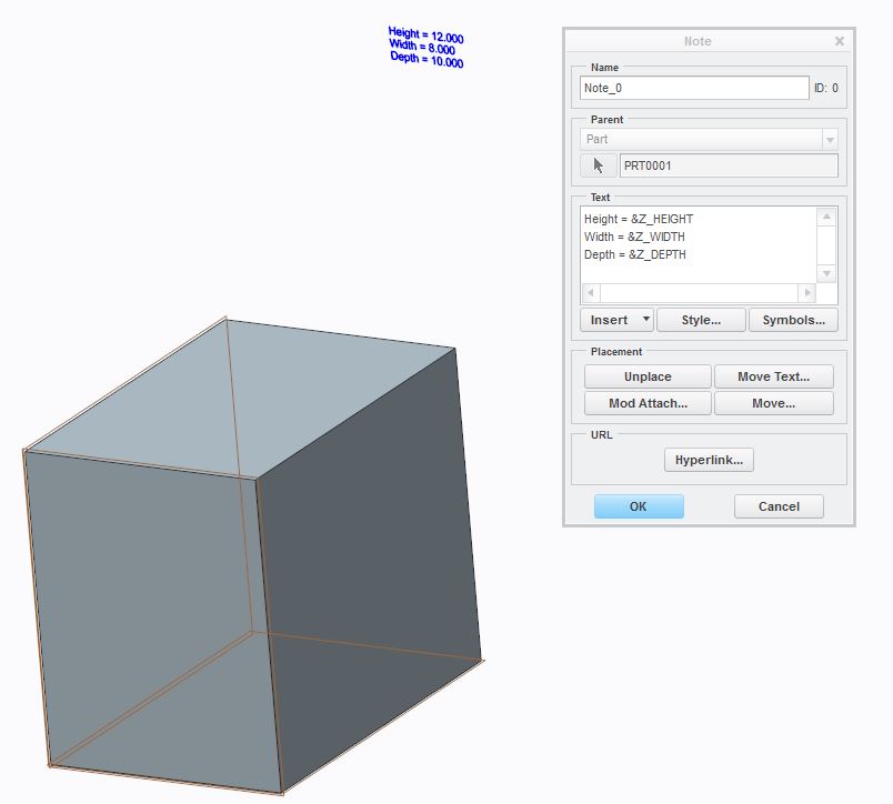

To do it in the part model, create an annotation note and reference your parameters with a &. See image below. When you double-click the annotation in the model, it will prompt you for the value of the parameter you double-clicked.
Edit: I should clarify that the parameters in the image above are named z_height, etc. Doing this in a drawing would be very similar.

This puts the annotation within the model, however I still can not click it to edit the parameters.
February 13, 2014
It works on my end. A few things to check:
  • Do you have a filter applied in the bottom right corner of your screen? It should be set to smart.
  • What version of Creo are you running?
  • Are the parameters in your model or a subassembly or another model?
  • Does the & show up in the annotation when viewing it from the model?
  • Do you have a relation that drives and defines these parameters?
  • Are you double-clicking the value of the parameter you want to change? A small window at the top of the screen should open up, asking you to enter a new value. If you click on another word in the annotation, it won't work.
