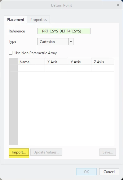

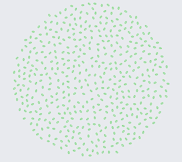

I want to build a model of a circular plate with elliptical holes in it. The holes center coordinate and orientation data are in a .txt file. The center coordinates and orientation are random. Can I make this type of tabulated pattern in creo, please if possible help me out
Circular plate radius is - 1024 mm
Ellipse semi major - 30 mm
Ellipse semi minor - 15 mm
I have attached the .txt file . first and second column is x and y coordinate and third column is orientation of major axis from x

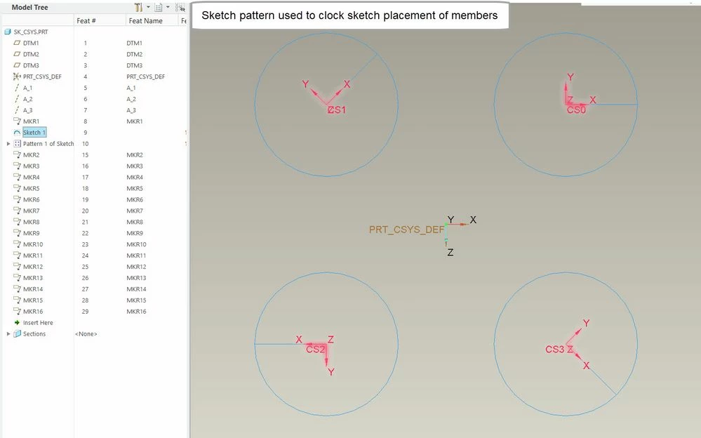

This should be possible using sketch patterns. Creo supports sketcher csys inside a sketch that can be patterned. The center locations can be imported using an point offset csys feature.
Offset datum point using import option
You can then create a pattern for the csys orientation (clocking) at each center location. See below.
Refer to this thread for reference:
https://community.ptc.com/t5/3D-Part-Assembly-Design/Is-it-possible-to-pattern-geometry-to-fit-to-csys-locations/m-p/705898
Here is a simple example of clocking the csys inside a sketch and patterning it. The part is posted for reference.

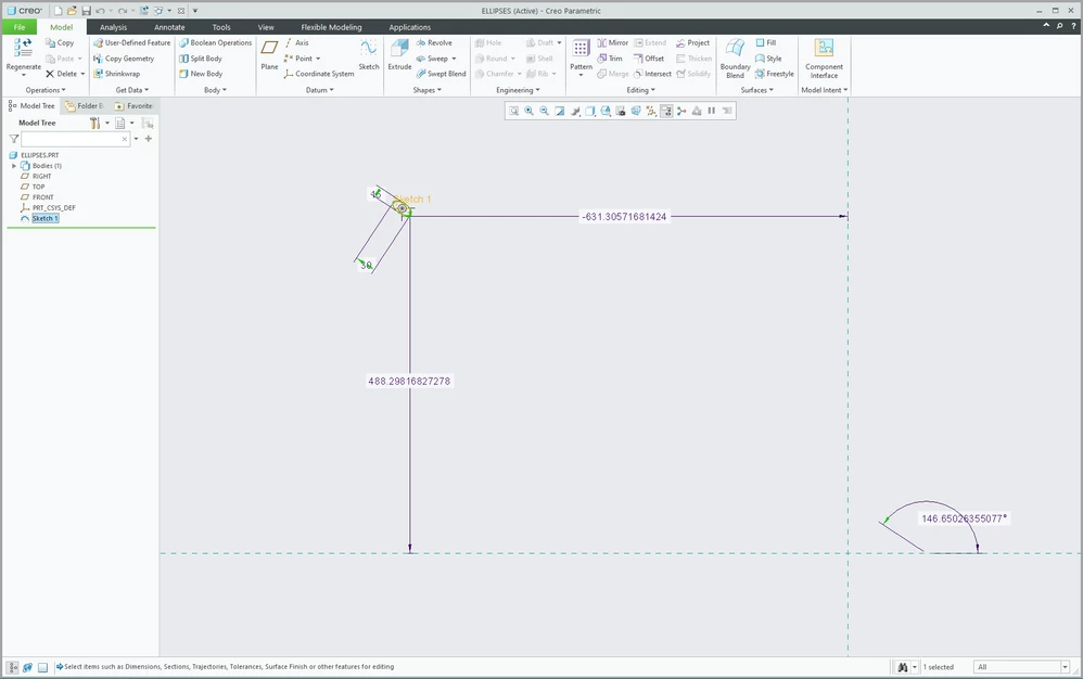

Mar 15, 2023 1:03 PM UTC
1.]
2.]
create 1st instance
3.]
create pattern ... see attached video
Hopefully it is what you need...
