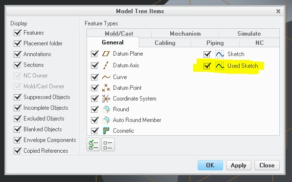

Here's how Creo 2 works for me:
[cid:image001.png@01CE2974.E952B5A0]
There was some discussion from another user a few days ago on this. There's a 'Used Sketch' check box under 'Tree Filters'. Perhaps that's cleared by default in Creo 2?
[cid:image002.png@01CE2974.E952B5A0]

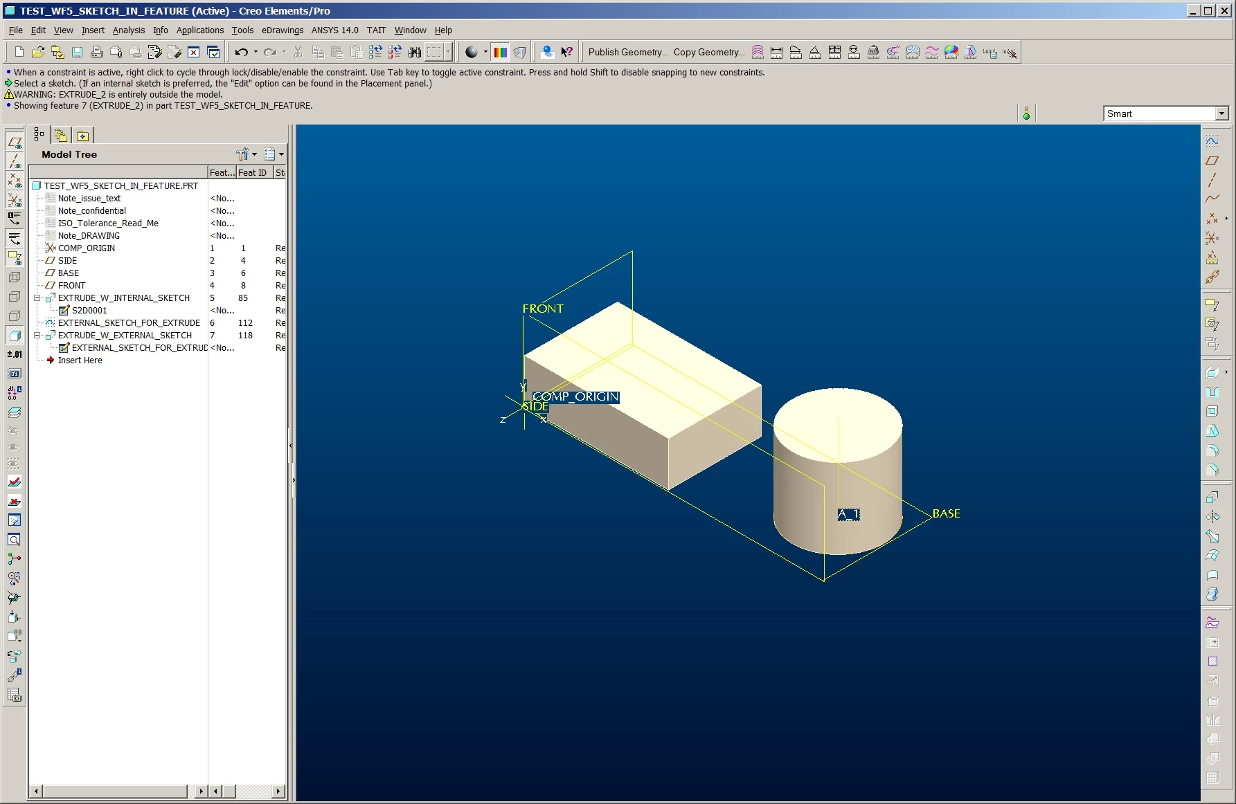

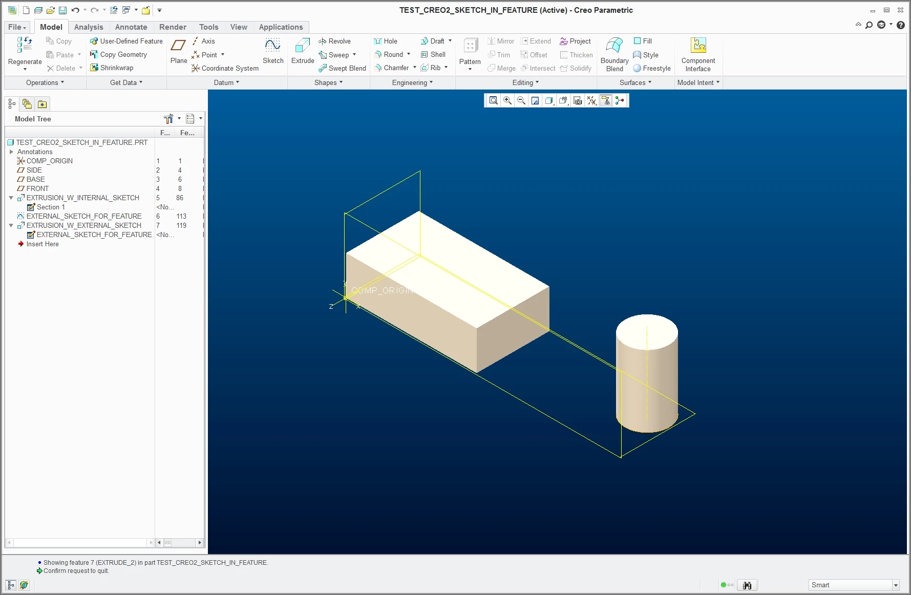

Hi Ryan,
I am not sure what you mean. Creo 2.0 uses an external sketch to make a
feature such as an extrusion and puts a link to it under that feature.
Seems like this is what you wanted. True that the default behaviour is to
hide the original sketch and maybe this is what you are not seeing. If
that is the case then it could be your tree settings. See Doug is already
onto this 🙂
As far as I can see this is the same behaviour as for WF5 and I have
attached a picture for that too.
