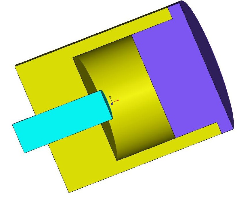

Hello Everybody
I'm looking for the calculation of the empty volume in an assembly , this volume will the the quantity of oil I need
If you have the good way of doing , please can you explain me
I'm working with Wildfire 4
Thanks a lots

Olivier,
There are fancy things you can do with Analysis Features to calculate volumes, but here is a "quick-and-dirty" method you might find useful.
Create a new part in your assembly called "Oil". Copy the inside surfaces from your assembly into that new part. Depending on whether or not you have the Advanced Assembly Extension (AAX) or not, you will or will not be able to use Publish and Copy Geometry features. If you don't have that capability, you can still select a surface in the assembly, Activate the part called "Oil", and copy the surface into the part. When you have all the surfaces you need, you can open the part "Oil", Merge the surfaces together, then Solidify them. Now you can do a mass properties calculation on the part "Oil". When not in use for calculation purposes, Suppress the part in the assembly, so that it is not fillling up the space and compromising the Mass Properties of the assembly as a whole. Good luck!

Hello David
I use your method and it work perfectly , now is it possible to to the same thing but without creating a new part ?
Olivier
July 1, 2010
Olivier
What is your problem with creating a new part? You can suppress it when you don't need it for calculations. You could even use a Family Table to give you the two versions. You really can't create a mass-bearing feature without it belonging to a part; you can create mass-removal features (e.g. holes and cuts) in an assembly, but not protrusions, etc. (An assembly is just a recipe for putting parts together; it has no place for independent mass to be stored).
If you really don't want the part in your assembly, another approach would be to create a copy of your assembly, add the necessary mass in the second assembly, and do a Cutout of the 2nd assembly with the 1st, leaving only the volume and mass of the oil chamber. If you take this approach you don't have to be as fussy about creating the additional mass; in other words it can overlap other parts (notably a movable piston, for example) because the system won't double the mass in the intersecting areas.
