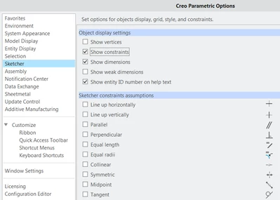

make a mapkey for them activates these "under-constrained" sketch-mode settings -
turn off the display of weak dimensions, and turn off all constraints from the sketcher:
it's not the same as the under-constrained mode in a cosmetic sketch, but it functions quite similarly.

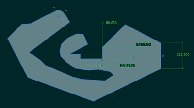

After doodling, start assigning constraints and dimensions "manually":

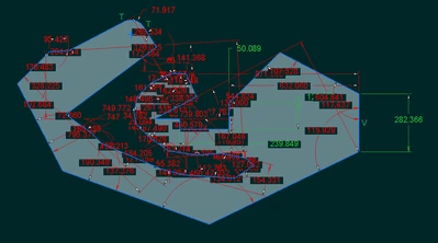

vs:
At some point, with the presence of 1000's of weak dimensions, the sketch could get bogged down, but for conceptual design, this works pretty well.
