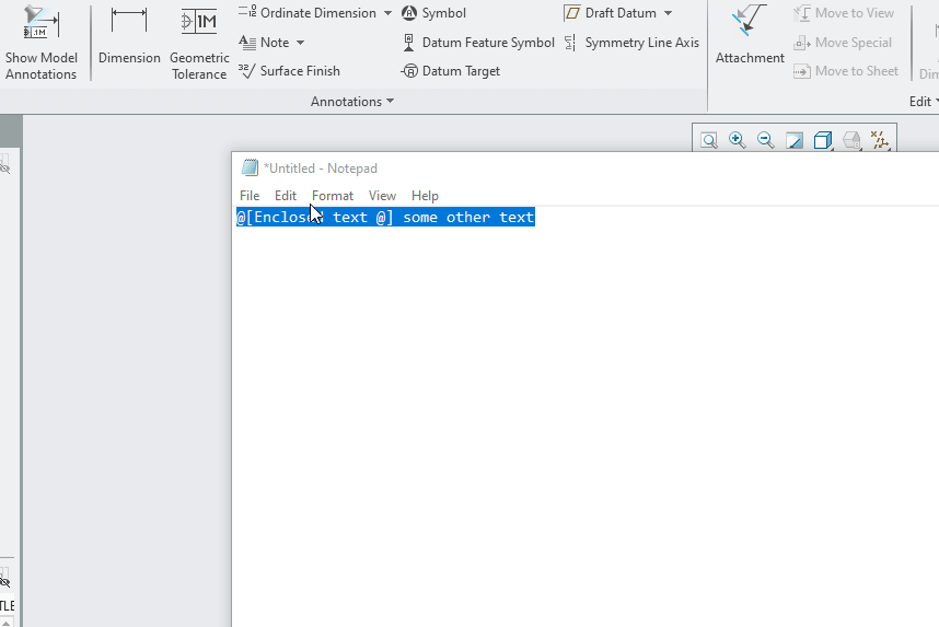

Hi, see attached gif I want to copy text from outside of creo (notepad or another text editor). I cant seem to copy text as "enclosed text". I try to copy "@[Enclosed text @] some other text" into a drawing note and it doesn't work. after I click properties, I need to delete the extra @ creo added. see attached gif am I doing something wrong?

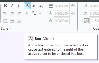

I am getting the same thing in Creo 7.0.  It also happens when typing in the brackets in the note.
This probably changed when they added the box button for box to the ribbon.  Definitely not good change for those used to being able to type in the text needed for a box or wanting to use copied text.

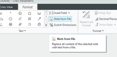

Don't copy and paste, use the "Note from File" command in the "Format" tab.
