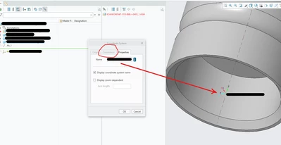

I am looking for help in basic MANUAL wire and cable routing for Creo 10. I am trying to self-teach but it’s become clear that I will need some level of formal direction. I am not working from any wire drawings or downloads that automatically populate the paths from an electrical engineered schematic etc... I need only to represent the 3D layout of the wire routes in the top-level assembly and transfer to a 2D drawing for visual representations used in Installation Drawings only.
I have midlevel modeling, assembly and detailed drawing skills to aid in my learning for this. Currently my greatest challenges are orienting my CSYS so that my Z axis (Assuming Z is a default connection for a wire path) is positioned in line to accept my desired wire path orientation. There does not appear to be any way to edit the CSYS which seems to orient randomly when placed. If I do try to edit and click on a since created centerline, it will loop it from the original Z axis pick, (90 degrees off my target orientation) to the centerline I created and continue to the opposite end connection of my wire.

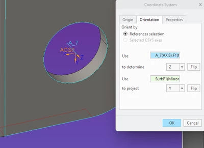

Jun 10, 2024 4:14 PM UTC
Orientation is achieved by selecting the orientation tab and setting how you want is oriented to what.
Also, I find that selecting arcs such as the edge of a hole works very well to place the Z along the axis of the hole.
Jun 10, 2024 4:49 PM UTC
Thank you kdurth. I have tried to do that as well. Sometimes I can edit through the orientation tab, but in this case, it is inactive. Note the Z axis is not pointing downward where I need it. If I knew how to place it on the Y axis I might be able to flip the direction.

Jun 10, 2024 7:13 PM UTC
Have you clicked on the Orientation tab?  It appears to only me to be in an inactive state (not selected).  What have you selected for the placement references.  For an axis, the origin references would be the axis and a plane and Orientation tab would require a plane, line or axis to fix rotation about axis.   Without the third reference on the orientation tab, in 7.0, I cannot complete the feature.
