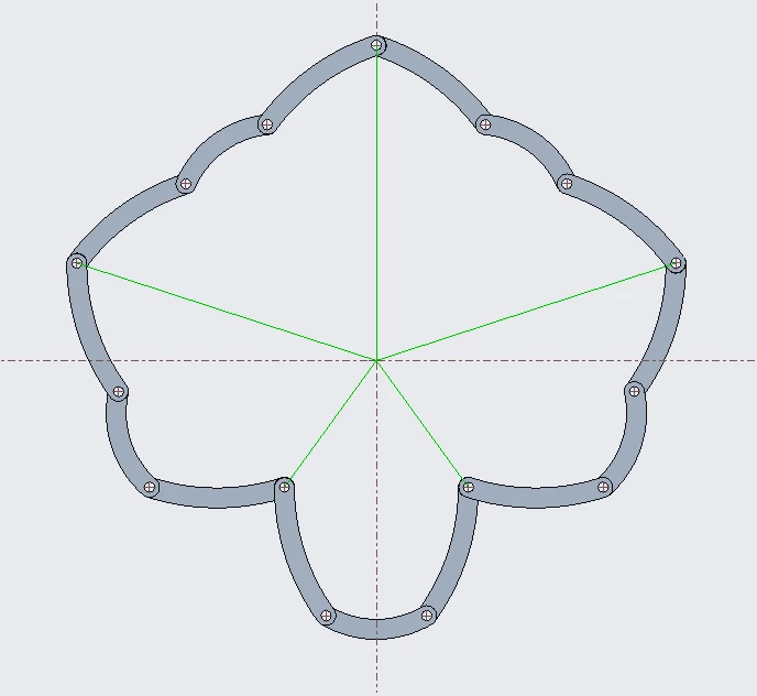

I would like to make these linkages move together, the easiest way to do this as I think is making the distance from the origin the same for the links (indicated by the lines drawn). However, I am unable to find a way to do that, any and all help would be greatly appreciated.
*I am using PTC creo parametric 9.0 student edition
see video.

Thanks for the reply but I am not sure how to constrain the sketch to the links in assembly, I would appreciate it if you could guide me further.
