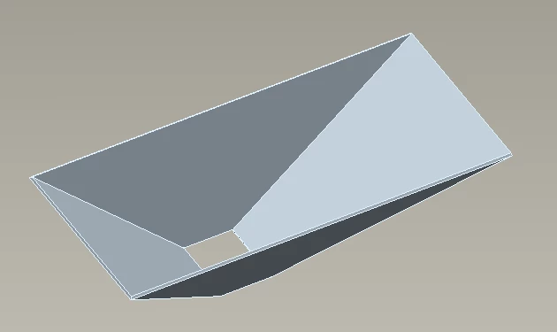

I have this pyramid that I would like to make a flat pattern of. For
some reason it won't let me rip one of the corners to flatten it.
Anyone have any clues why? I tried to do an edge rip using the inside
or the outside edge and all I get is the message "Could not construct
feature geometry"

Tony,
I tried it in WF5 M060 and it seems to work all right.
I constructed one as a solid blend, selected
Application<sheetmetal<shell to=" create=" the=" first=" wall=" and=" then=" tried<br="/>both the Conversion button and the Rip button from the sheetmetal
toolbar to assign the rip corner and it worked fine with either one.
Varying the shape of the part dramatically doesn't seem to cause it to
fail, either.
James

Hi Tony,
Spoon feed it.
Make a solid of your final geometry. Add rounds for bent edges.
Add cuts for bend relief. Add cuts for material edge. Shell it.
Then import to sheet metal and flatten it.
Using this method also gives you amazing control over the end geometry.
Bend relief often fails when the edges are not perpendicular.
Just spoon feed it until it works.
Best regards,
Frederick Burke
