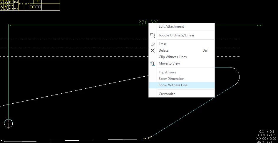

Hi
I'd like to know "Erase Witness Line" control option from config.
please look at image
witness line is delete active. i'd like to how to know unactive it.

If the witness line has been erased or if the view is partial, select the dimension, RMB, select Show Witness Line and CREO will show it.

The double arrow on the right typically means the end is outside of the view.  Is this view a partial view?  Go to the view properties / visible area and make the view visibility full view.
