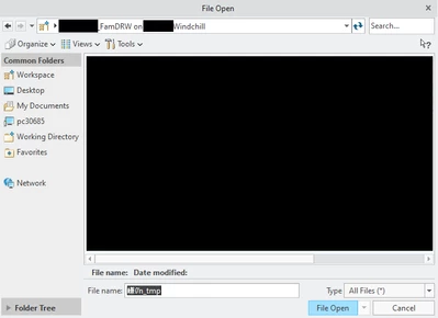

Additionally I've encountered that Creo has the following characters in the File Name input box, when pressing the "File"--> "Import table..." button within the family table: 嵰᠑ʼn_tmp , this might indicate that there is something strange going on in my model?

Can you do me a favor? Can you save a backup of the data to the local drive, get offline from Windchill, open the data from the local drive and then try reproducing the issue?
