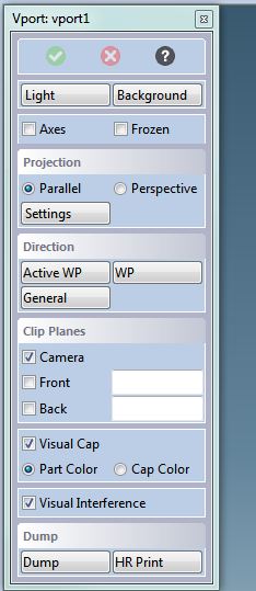

In modeling, right click and select "Viewport Properties...". Under the Projection heading make sure the Parallel is checked and not Perspective.
If perspective is checked, then Annotation will not be able to create the views and will give an error like the one you are getting.

I made sure the parallel is checked, but, so far the same error. No matter how simple the model, the program returns the same error when I try to produce a detalied drawing. The computer is new, and fairly strong. I can't see it being pilot error as I have used other CAD systems for years.I almost thik there should be some was of system checking the program for errors or something.
