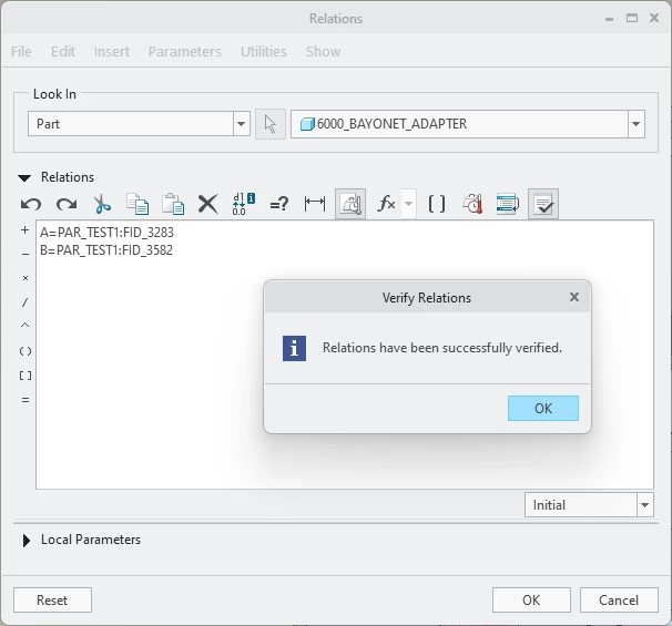

If I understand what you are asking it relates to model parameters versus feature parameters. See this example of the same parameter name used in a part model. "PAR_TEST1" is defined as a feature parameter for two different extrude features in a model. They are two unique and independent parameters available for use in the model as they are defined in the context of features and not the part. You can see there are two parameters with the same name in the part and they are independent.
This is possible if you create feature parameters using the same parameter name. In this example below A is not equal to B even though the same parameter name is used twice in the model.

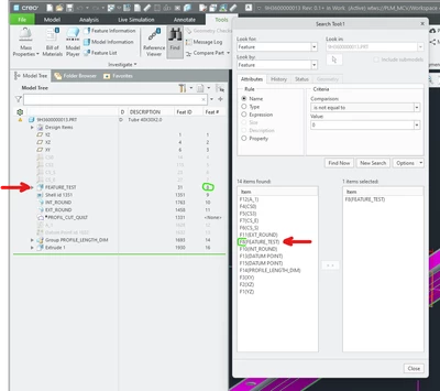

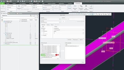

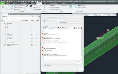

But something wrong with all types of equations in my relations.
Please see attached photos to try to configure the source of the issue with me.
Thank you again for your efforts.

I think the issue is that in your relations, you are trying to use part Dimensions like you would use feature parameters.
In your last example, PAR_TEST2 is a dimension that is from feature FEATURE_TEST
To assign this dimension a value through relations, you don't tell the system from which feature it comes.
For your example, you simply write:
PAR_TEST2 = 1.234
or if you have a part parameter AAA, then you could assign its value to a dimension:
AAA = 1.234
PAR_TEST2 = AAA
(the value of a parameter that belongs to a feature has be recalled using the special :FID_xxx syntax as described in this thread)
