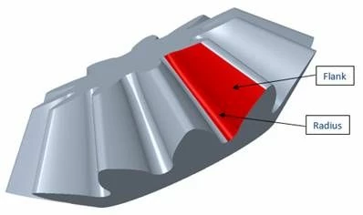

while importing step file of gear,
the radius and flank surface are getting merged,
How can we have seperate surface/ face for both selection,
Image Description ( while selecting flank radius is also getting)image003.jpg
selected )
The surface for radius and flank should be different.

What is the nature of those surfaces in the source file used to generate the STEP? Is the source file a solid model or surface model?
Is the import into Creo generating a solid model on import? If so, then there is surface connection information in the STEP file that creates quilts from surfaces that may be visible in the source file.
If the surfaces of interest are separate surfaces in the source file then filter the export from the source model to export only selected surfaces.
Aug 17, 2022 11:30 AM UTC
Step File is generated from the KISSSOFT SOFTWARE  and driectly exported into step file

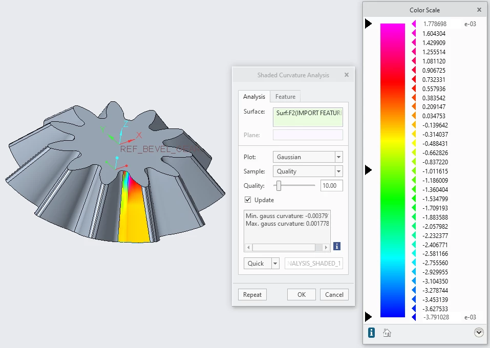

You could try using the "Remove" command with the "Leave open" and "Keep removed surfaces" options and that should keep the surfaces as a separate quilt.
Aug 18, 2022 1:11 PM UTC
just a note ... selected surface does not contain cylindrical sub-surface (no round surface is present).
