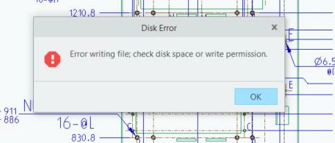

I am getting the error pop up when trying to save file in a Specific folder.
"Error Writing file; check disk space or write permission."  * This Is the Error

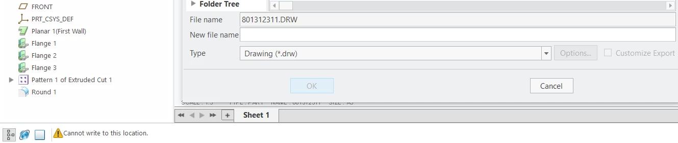

I am Getting Error only on 3 Specific folders only. (I have all access permission. to the drive). Other folder in the same drive are working fine.
1. I have created a new folder tried to save some files it works fine but when i copy 11GB of all drawing file and paste it  in the same new folder i am getting the same error.
2. i am able to copy and paste using file explorer it works.
3. only with CREO i am getting error writing file.
Recently our organization changed local Server to Cloud Server from then i am getting the error.
Kindly help me in Resolving this issue.

Hi @Sam_Ebenezer97
I wonder if antivirus or firewall is detecting a program (Creo) making large data transfers rather than Windows Explorer performing these tasks.
Is there a specific reason why you need to use Creo to perform these Windows Explorer tasks?

H Mike
Actually i am unable to save file in the Drive on one specific location, but on the same drive i am able to save on all the other location.
i am unable to save files directly from CREO only, other software's (Solid works or coral draw) are working fine and files are getting saved on the specific location.
