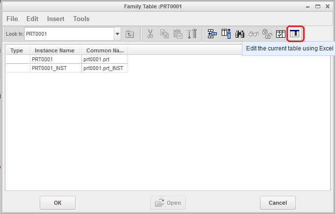

You can use edit with excel option then copy from your excel.
>First insert an instance.

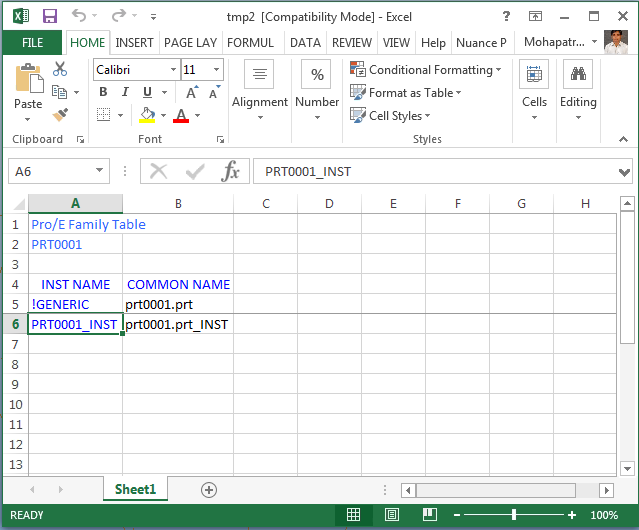

> Then select edit with excel
Now you can copy to this xls.

Since, this option is available, but I want to minimize the effort of copy & paste because, copy and paste is more prone to errors and it become difficult if there are hundreds of parameter. I am fine if any third party integration is available which can directly read the excel file.
February 29, 2016
How often do you have to do this? Is it really worth the effort to develop a tool for a limited use case?
Cut and Paste  works and does satisfy the requirements of being able to import an external spreadsheet into Creo to create a family table.
