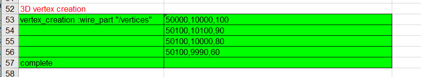

February 7, 2017
Building on this idea-if you put all your commands in one column and the points (separated by commas) in an adjacent column of Excel, you can copy and paste into the command line of Creo Elements/Direct, hit Enter, and it creates the "wire" part containing the vertices all at once.  You will want to turn on Vertices in the Show Properties of the viewport, so you can see them once created.  See below (copy and paste green region from Excel into command line of Creo Elements/Direct Modeling):
