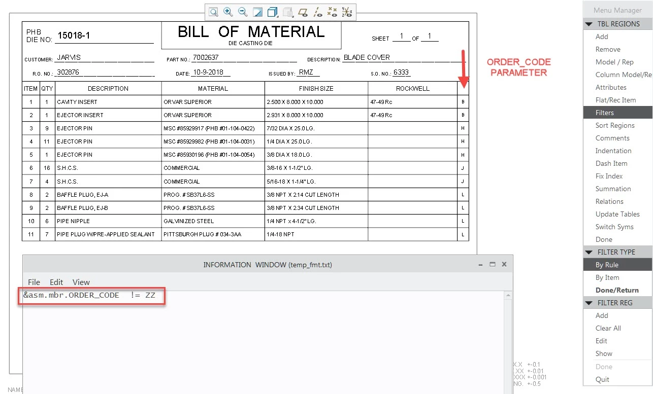

In our assembly designs, we use two methods.
1.  Add a filter to the repeat region that drives the BOM table.  See the attached picture.  We have a parameter on each part called Order_Code.  We use this parameter to group parts of the same material type within the BOM table.  We chose ZZ to be the value for excluding from the BOM.
2.  Create a simplified representation that shows only the items you want to include in the BOM.  Use that simplified representation to drive the repeat region in your BOM table.

Thanks for the response, but I was looking for a more direct way to do it (like Solidworks)

The method in Creo for repeat region BOMs on the drawing is to use TABLE, REPEAT REGION, FILTER, BY ITEM, EXCLUDE and then pick the bom table lines you want to exclude from the BOM.
If this is something that is always excluded, you can set up rules for filtering, as the other user stated.
