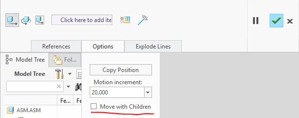

November 12, 2020
"as i can move one part say a mold plate, and then copy everything else to its new location (screws and such)"
Btw, there is an option called "move with children". It might make it easier
