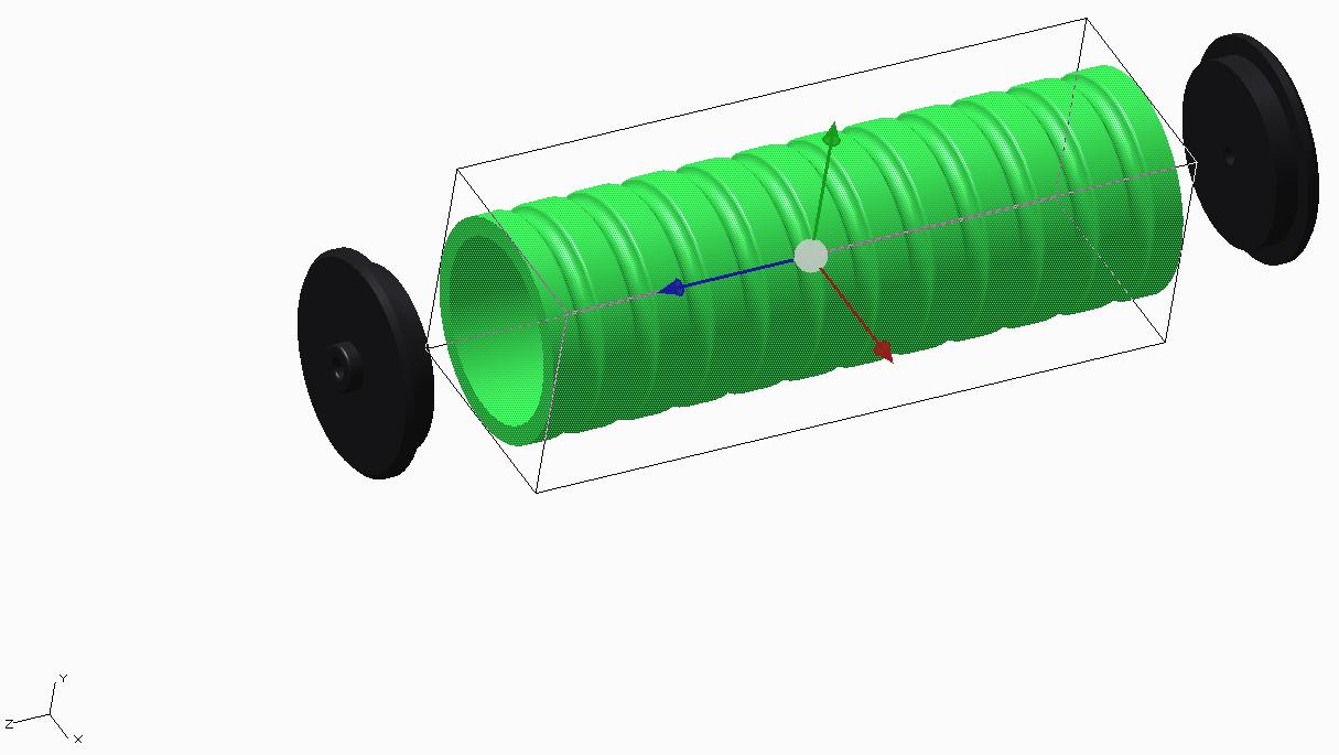

I am using Creo Elements View and if I try exploding an Pro/E assembly, its not happening.
Kindly help and I attach the file herewith.

Hello!
I opened the assembly in Creo View Lite 1.0 and manually moved the components of the assembly (in the direction of the axis Z):
P.S. Also, you can watch the video "Moving and Exploding Parts" by disassembling of components of the assembly (there, also, option implementation is shown "Smart Exlpode") in Creo View 1.0: http://learningexchange.ptc.com/tutorial/764/moving-and-exploding-parts
All Creo View tutorials here, at LearningExchange site: http://learningexchange.ptc.com/tutorials/by_sub_product/sub_product_id:15
