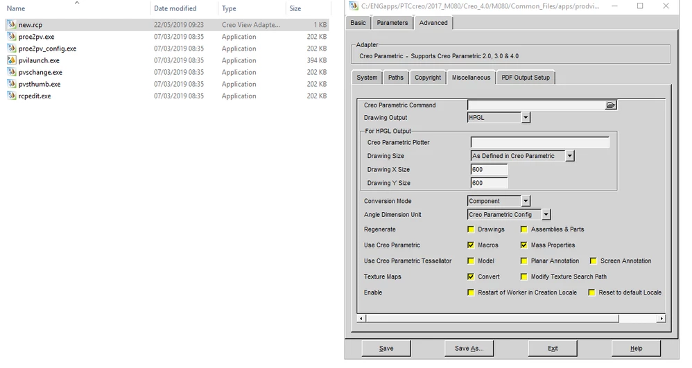

I have a Creo model which I want to save as a .pvz and include textures.
I have created a recipe file called new.rcp which has 'Convert' selected under 'Texture Maps' (as advised in CS75925)

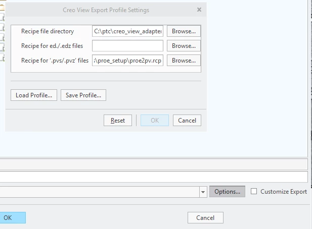

Within Creo, under 'Save As' I selected .pvz and then click 'Options' and add the directory where this recipe file is located. I also add the recipe file itself under 'Recipe for .pcz'.
However when I hit Save I get 'Creo View files could not be created'.
Can anyone advise where I'm going wrong
Best answer by MartinHanak
I can see hpgl.png in recipe editor window. I do not think that this data format is the right one.
