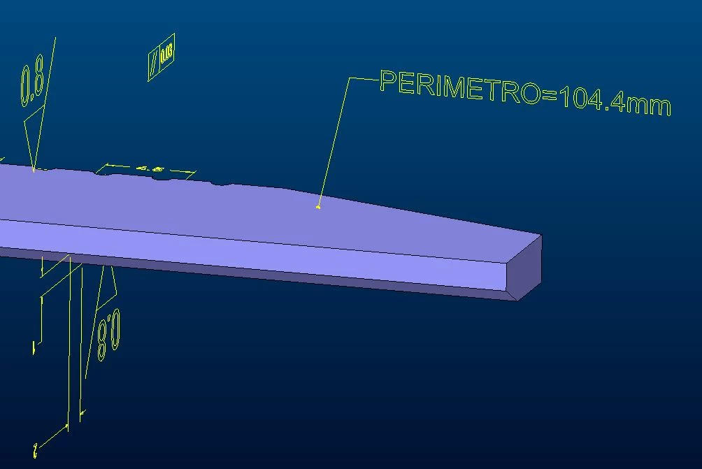

I want ro read onto step file the annotation make in a part as dimension, tollerance and note.
How to export, in a step file, annotate as note?

I had already tried this. But it is correct that when you import the step file the annotations become symbols?
What I want to do is to have in the step file, physically, only the value and position of the notes, not all the points of the text transformed onto line.
See "#NNN = ANNOTATION_PLANE" section "CARTESIAN_POINT" in the step file, just open with NOTEPAD.
Many thanks for your time.
Greetings Luca.

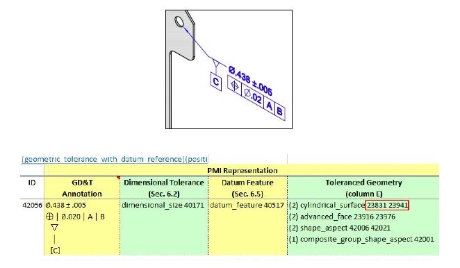

it looks like Creo exports annotations as graphical representations. See https://www.ptc.com/en/support/article/CS193762 document.
I suggest you contact PTC Support and ask them the same question.
