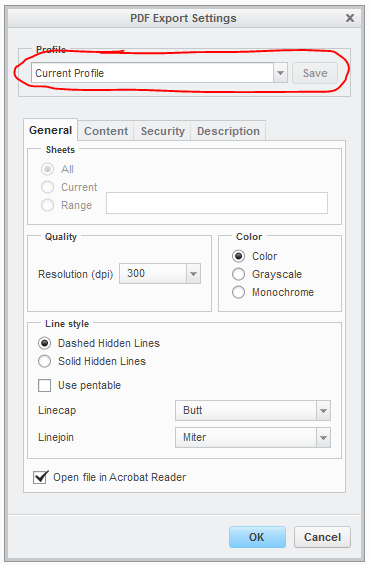

You should be able to save the PDF settings that you want and then recall them before saving the PDF.  Once selected, they stay active for the length of your session.  If you're using a mapkey to save PDFs, you could always have the mapkey select the desired profile first.

Hi Juan,
This article should provide some information on how to create the profile:
CS31414 - How to create a 2D PDF Export Profile in Creo Parametric
In case you are unable to access the article, here is the information from the Resolution area:
Take below steps to create PDF Export Profile :
  1. Click File > Save As > Export Choose PDF option > Settings
  2. The PDF Export Settings dialog box opens
  3. Specify a name for the profile
  4. Set the PDF creation options for the profile
  5. Click Save to save the profile
  6. Click Cancel to close the PDF Export Settings dialog box (Alternatively, click OK to save the PDF export settings)
The 2D PDF export profile has .dop (Dex Output Profile) extension and will be stored in the current working directory
Config.pro option intf_profile_dir can be defined to specify the default profile folder for selection from drop down list
