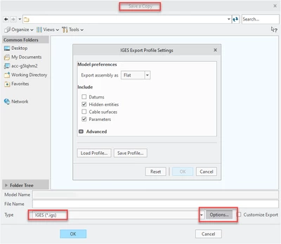

File->Save As->Save a Copy and select IGES.
You have the option to customize your export
