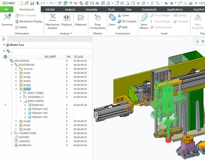

Hi Catalina and thank you availability,
I need to group the elements contained in the rigid body (Ground, Body1, Body2 ......) in a new assembly, or better yet export the individual rigid bodies as STEP or others format.
Best regards,
Matteo
Van_AG
Feb 24, 2025 2:29 PM UTC
Create simplified representations based on mechanism bodies.
Then export representations to different IGES files and import them as parts.
