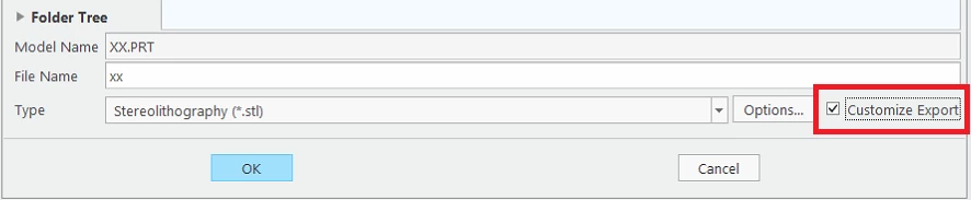

Does anyone know what happened to the STL export dialogue box?  It used to offer the ability to modify the Chord Height (etc.) before creating the file.  Is that not an option anymore?
My only concern is that, sometimes in the past, going with the minimum would give an unusable file.
If I can't change it for the 1% of the time I need to, that could be a problem.
Best answer by MartinHanak
you have to check Customize Export option before clicking OK.
January 30, 2018
That did the trick, although I was sure I tried that yesterday.

You may like Config option Intf3d_out_configure_export as Yes
