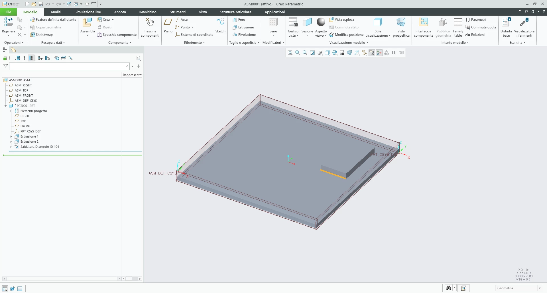

I am experiencing an issue when exporting a model from Creo Parametric to STEP format.

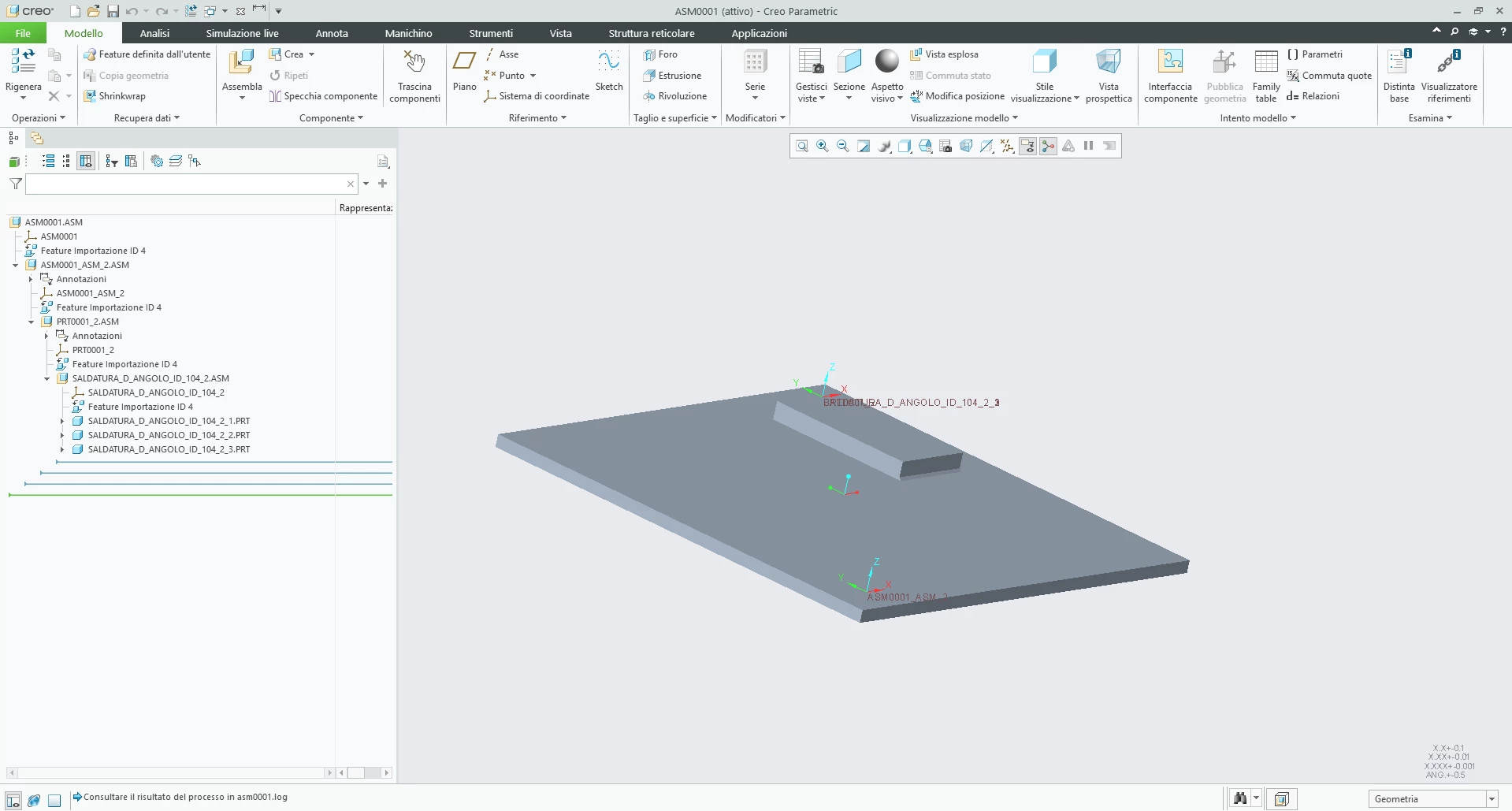

When I create a model as a single part and then add weld bodies, Creo automatically generates additional bodies and layers during the export. When I reopen the exported STEP file in Creo, the structure of the model appears completely different from the original one created in Creo.
Could you please help me understand why this happens and how to correctly export the STEP file without the model structure changing?
Thank you in advance for your support.

    Thanks for the replies. Let me explain: I need to export the geometry of a composite model as follows:
    Assembly --> Single Element --> Welds inserted at the single element level.
    In this case, in all exported steps (203, 214, and 242), a different structure and bodies than the original are exported. When reopening the same file in Creo, it is incorrect.
    MarcoMal5-Regular MemberAuthor
    Nov 11, 2025 8:14 AM UTC
    I attach an example of the original model and then the same by opening the step file

    This is a case of "Works to product specification for Creo Parametric"
    When importing step models, Creo creates an extra assembly. This is done I believe to have a place to stick all of the annotations and misc things that come along with the step model.
    This is a known issue. I believe that PTC has stated they are thinking about trying to correct it in a future release but I don't believe they have yet.
