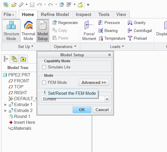

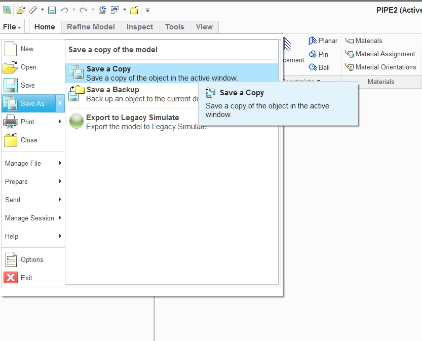

Ruben:
i think for Nastran, the best way is to go to FEM mode
For vrml choose file Save as, Save a copy and select .vrml as filetype

Ruben:

I have exported to VRML before.  There are several useful options in the export routine.
