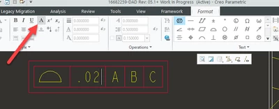

Hi there,
I am looking for a way to save a draft group to a file and importing it later to another drawing.
Background:
I try to define a drawing note according to ISO 22081. Works fine so far.
I use a draft group, which consists of a common drawing note and a geometric tolerance dimension
Please let me know how to export and import the draft group or if there is a better way to get the ISO 22081 note to a drawing.

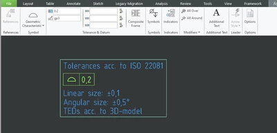

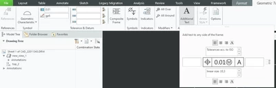

Jun 9, 2023 12:10 PM UTC
I think, I have got it (works so far for me).
By using the "Additional text" option of "geometric tolerance" feature, I no longer need a draft group.
Everything fits now in on single mapkey:

Mat16-PearlAuthor
Jun 8, 2023 12:30 PM UTC
Thanks for Your reply.
I was afraid that saving draft groups just is not possible.
I tried converting the draft group to a symbol, but unfortunately I lose the ability to modify the dimensions.
But the "edit symbol" - interface is quite ancient and I am not very used to it. So maybe I am missing something.

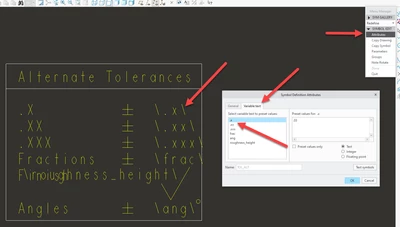

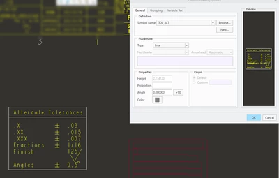

Jun 9, 2023 10:56 AM UTC

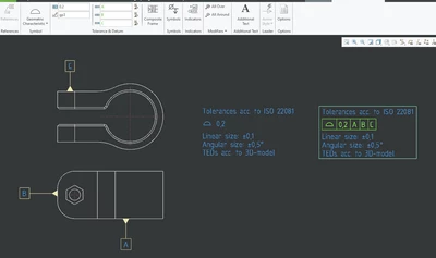

Maybe I misunderstood.

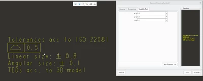

Does it always look like the image, but only with different values? If so, a symbol with variable text would be perfect.
My quick symbol attempt is attached (creo 6)

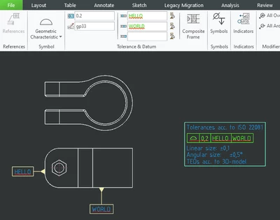

Mat16-PearlAuthor
Jun 9, 2023 11:13 AM UTC
Unfortunately, the components "A B C" (reference planes) are also dynamic.
(Creo prefers references with single characters as names, that is why "Hello" and "World" is underlined)
StephenW
Jun 9, 2023 11:23 AM UTC
Ya, if you must have the GD&T reference frame truly connected to the model datums, then I don't know how to make that happen.
The symbol could easily be modified to include the datum names as variable text but they would not be connected to the datum names in the model. Your users would have to modify them to match. It's a step in making it quicker but not without manual intervention.
