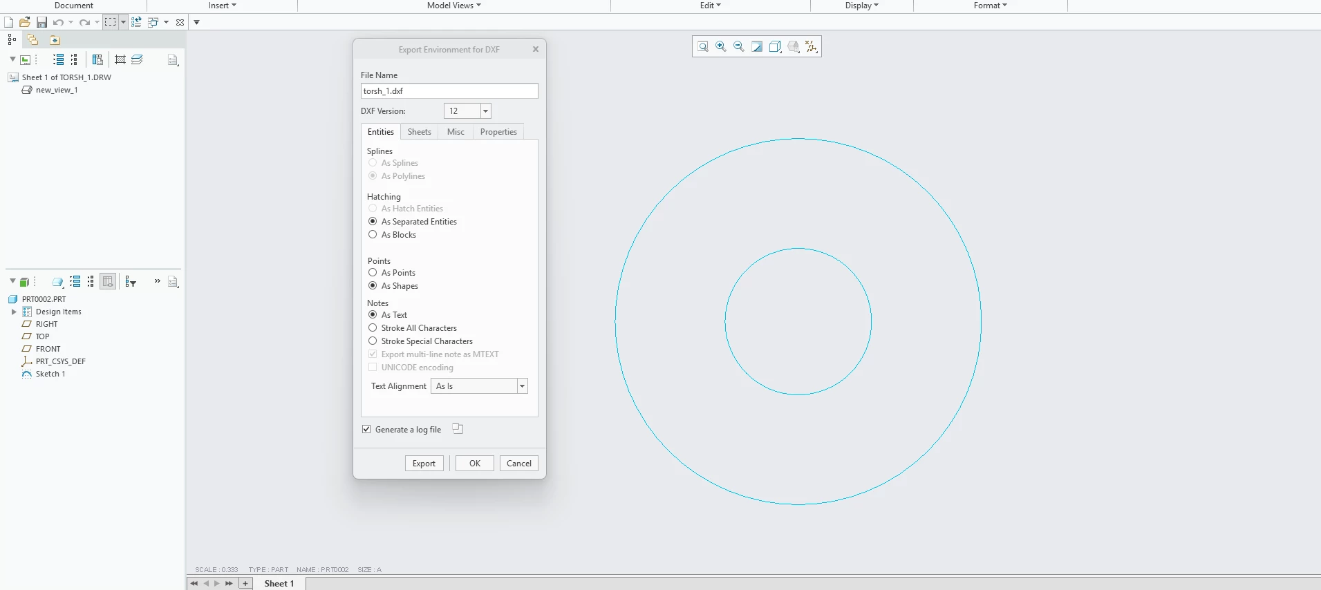

I have creo 9.0.5. I'm trying to export a .dxf file so that i can import it into my plasma table software (torchmate V9). The problem is when I go to import it into torchmate, nothing shows up. A long time ago Creo support helped me change some export settings and we got it to work but I've forgotten since then. Any ideas?

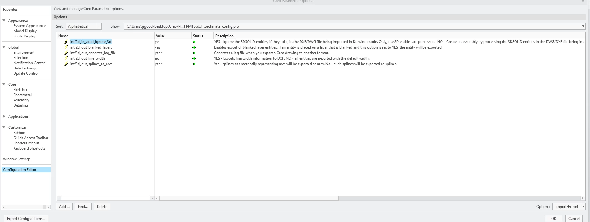

Perhaps the dxf_export_format config option to set the version of the exported DXF?
Jan 16, 2026 2:43 PM UTC
Here's a pic of my config settings right now, these aren't working. Maybe there's another I need to toggle?

I don't have any settings for any of the "intf2d..." parameters, so I'm working with defaults on them. The thing that kills me when I send files to people whose machines need them is often the version of DXF I'm giving them.
Some things to note that have troubled me in the past:
(1) I assume you're trying to output a 2D profile. This should be done from a full scale, 1:1 drawing from Creo. I usually make a drawing, no format and an appropriate sheet size to fit the part, scale 1.0.
(2) When I go to output the file, in the dialog box that pops up, I check the "Customize Export" box.
(3) After turning on Customize Export, I hit OK and another dialog box comes up with a bunch of options. There's a drop-down to select the version of DXF you want to create. Your machine probably needs a very old version, probaby older than the default that comes up.
(4) By default, a log file will be created for the conversion. You could look in there and see if any errors occurred, or if the thing actually did anything. It should spew a lot of stuff about what it did if things worked okay.
Some of the output formats in Creo allow us to set up defaults for stuff, like the STEP output. I don't know if DXF has any of this sort of functionality provided, but it is something you could look into.

No hidden lines is on and scale is 1:1. What do you mean remove format? I've tried making a sketch, then a drawing from that sketch and exporting that, didn't work. I've tried creating a solid from the sketch and exporting that, didn't work either.

Units match, no dimensions or text, set to an older version (I've tried all the available versions), no hidden lines, I don't think there are any unseen layers, scale is 1:1, and the paths are closed. Theres got to be a setting somewhere I'm missing.
Jan 16, 2026 5:50 PM UTC
Wait wait, I deleted all the layers and its finally appearing in torch mate! The hole isn't cut out but the path is there.
