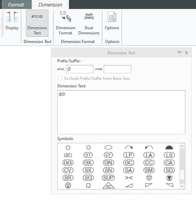

This is already supported in Creo. all you would need to do is to update the following model/detail option via the File-->Prepare-->Model/Drawing properties--->Detail options UI.
After updating the "symbol_font" detail option to any value other than "legacy", you will get the extended text symbols pallet:

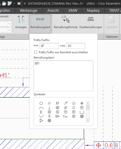

Thanks @Mfridman for the tip. I can adjust the detail option as described, but unfortunately I don't get any additional symbols. Are there any other settings that I need to consider?

Please note that the symbol_font detail option is applicable only to annotations that are owned by the object in which you have updated the detail option (drawing/model)
E.g. if you have a drawing with a shown dimension (owner is the model) then it would not be enough to update the symbol_font of the drawing, but also in the owner model of that dimension. Drawing owned annotations would use the symbol_font of the drawing...
