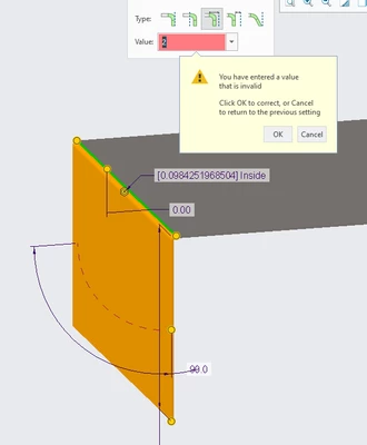

Extended flange in Creo sheet metal

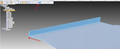

How can I define the length of a flange like this in Creo?  Offsetting its distance like this in SE

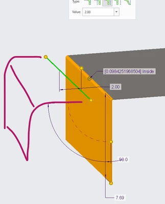

6-Contributor
Oct 17, 2025 12:29 PM UTC
It doesn't let me extend the flange out, only cut it in.
Or even extend this flange to another surface rather than a dimension offset?
