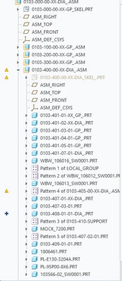

External Copy Geom NOT regenerating in Family Table Instances
For Example:

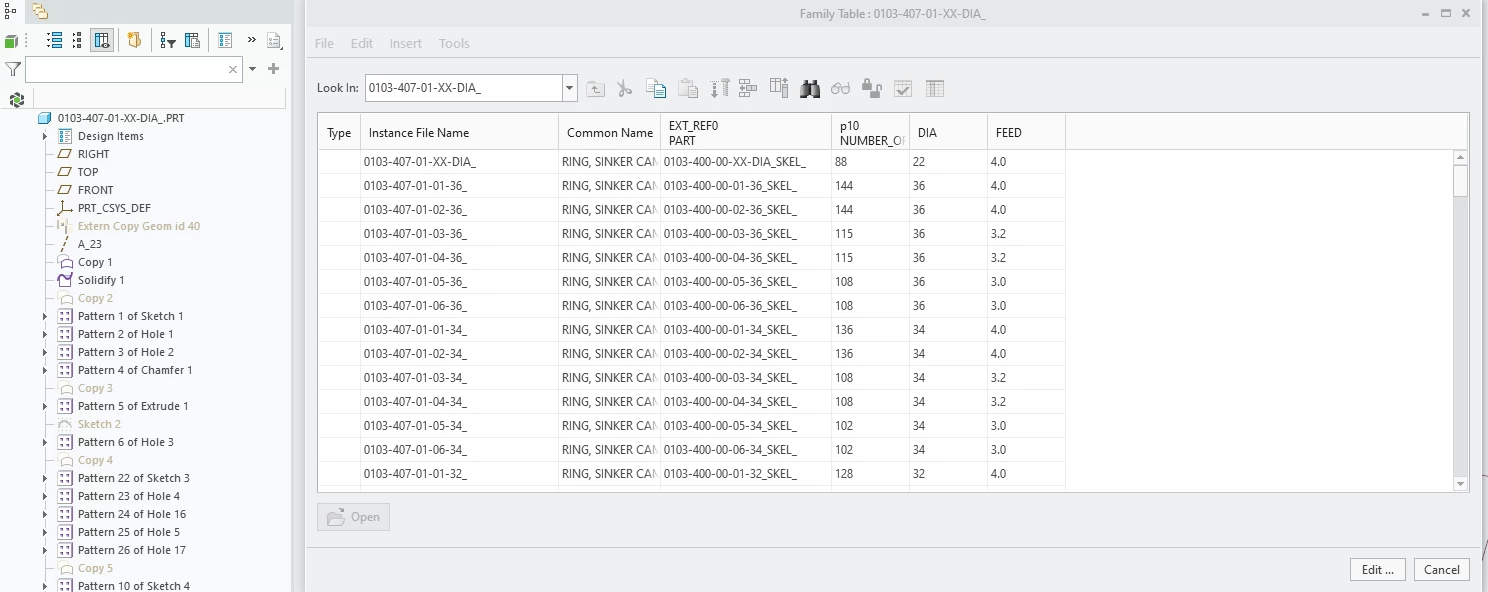

- I have a skeleton model with a family table with 100 instances.
- I then create a PART with a family table with 100 instances with the External Copy Geom (set to auto update) of the skeleton
- When I very all instances of the new PART and open one of the instances the External Copy Geom is NOT regenerated for that specific skeleton instance and I have to manually edit definition for it to regenerate correctly. (This is NOT an ideal way of verifying 100's of instances)
Is there any way I can fix this issue. Its a major issue for my design team. We are in Creo 10

Follow up! I may have figured out my own issue. If you are to make a TOP DOWN design and have a skeleton model that has many (in my case 120) instances with varying dimensional features. In order for the PART level file that has the skeleton placed in as a External Copy Geom. to properly regenerate the correct instance the Creo server needs to be able to recognize the instance of that said skeleton instance (open up each of the skeleton instances created). I had previously not opened up all 120 files to check (which who wouldn't blame me). Once Creo has physically opened the files that have been called for each part it will properly regenerate when you do make and changes in said Skelton file instances. Wish you didn't have to do this but guess their is no way around it.
In saying this I would NOT recommend opening each PART level instance due to regeneration time and click patterns. I opened up the Skelton model instances one-by-one and then went back to my PART file Family Table to then verify each instance.

Family tables may not be the most resource efficient way to capture this design intent. Without understanding the geometry and design intent one is not able to assess what may be an alternative to what you have done. I have found that the automatic regeneration option for copy geometry is not understood well by many users. Creo will only regenerate the copy geometry if something occurs in the Creo session to require a regeneration. Simply retrieving a part and opening it will not necessarily trigger a regeneration of the coy geometry feature. One must also have the master model in session in order to regenerate a shared geometry feature in a derivative model.
Family tables would not be my first choice to manage 120 versions of a part that is subject to ongoing change and controlled by a parent model(s).  If can explain the use case of why the skeleton model is changed to drive 120 instances, then someone may come up with a better way to manage it.
