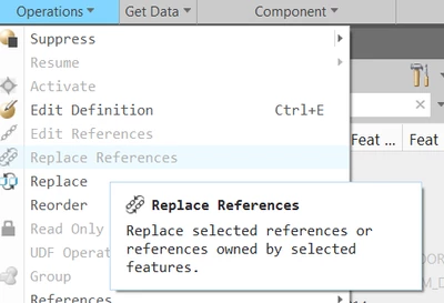

Hello everyone,
I can't find if there is a direct way to find out which of the elements in an External Copy Geometry feature have dependencies (children) in the part this feature is in?
Example: A part has an External Copy Geometry feature that references a Publish Geometry in a skeleton part. It contains a number of datums. Only some of those datums are actually referenced by the features further down in the part's model tree. I want to simplify the Publish Geometry / External Copy Geometry by removing the datums that are not referenced in the part. Is there an easy way to find out which datums are not used? With the reference viewer I can see which features are dependent on the External Copy Geometry feature, but not which elements from the External Copy Geometry they reference?
I hope it's clear what I mean...  The reason for asking is that I want to cleanup the external references and  skeleton part and remove those elements that are no longer used.
Currently I would have to check the references for each feature that is dependent on the External Copy Geometry one by one and write then down. After that I would compare this list to the elements in the External Copy Geometry to find which ones are not used. That seems like a ridiculous amount of work. There must be an easy way?
Thanks in advance for any help!
pausobAnswer
Sep 15, 2022 11:16 PM UTC
Here's my idea that might help you:
Select your extern copy geom (ECG) feature, and then do Operations -> Replace References
You will get a list of all the entities and features inside the ECG that are being used as references by the downstream features in the model...

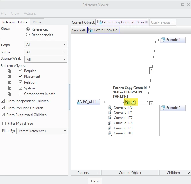

tbraxton
Sep 15, 2022 11:26 PM UTC
@pausob Your approach is useful. It is worth noting that the same list is available in the Global Reference Viewer. The same data is presented in the GRV when you expand the double arrows in the ECG icon in the GRV window. An example is shown here. It will only list references that have children.
