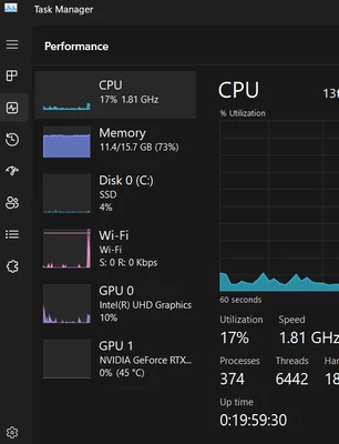

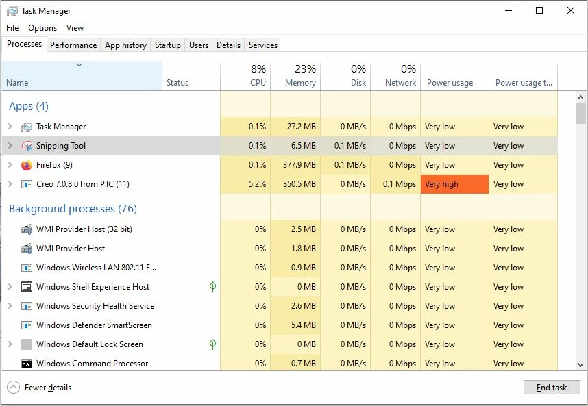

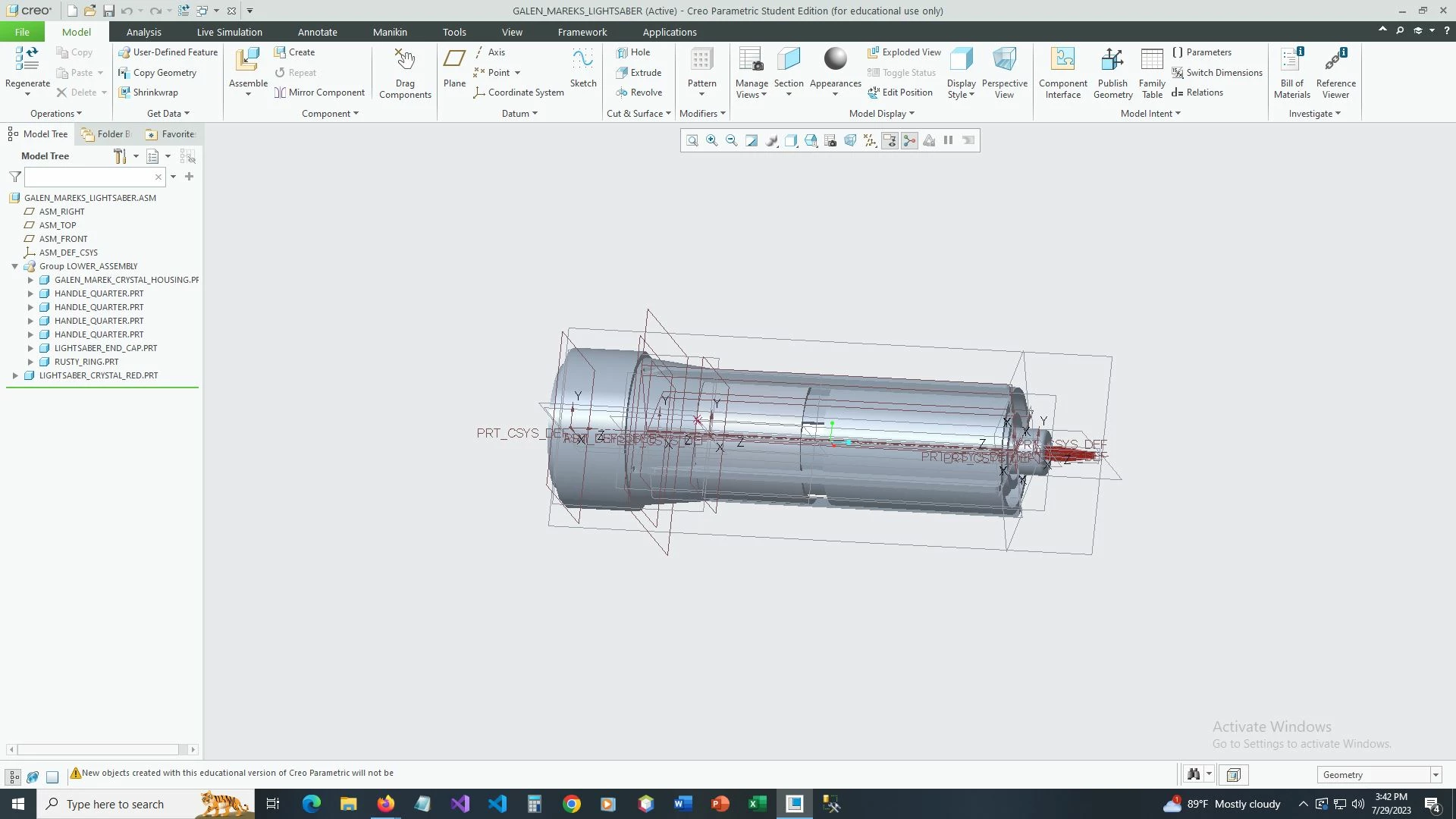

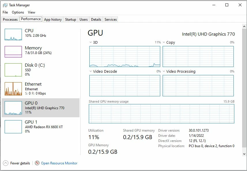

Can you send a screenshot of your task managers performance tab (like the one below) while it is freezing and also a screenshot of the type of assembly you are running. Do you remember any specific event/update to when it started performing differently?
Jul 29, 2023 8:48 PM UTC
No, I just started using it again yesterday, so this was the first time that I had used it in a while. As I noted earlier, it was working before I used my SSD in my laptop. While the SSD was in the laptop, it added some Dell software items, like drivers for their sound system etc.
The pictures that you requested are listed below. Honestly, this is a rather simple assembly compared to the one that I created while in my CREO college course. I believe that that project (a small-scale windmill) contained about 50-70 individual parts whereas this one only contains 8 parts. The only difference in this lightsaber project is that I used pictures (for the color of the parts) to add detail to the individual parts. As you can see, there is no longer any sort of color on the handle portion. Somehow, they disappeared. I had deleted the pictures on my desktop used for the coloration, so maybe that is what is causing the problems here?

Add the following option to your config.pro
graphics win32_gdi
The setting graphics win32_gdi  is to help troubleshoot vidoe card problems with your system.
If the problem is solved with this setting, that means you have a video card problem.
Remove the setting and try updating your graphics card driver. You may need to try several drivers to find one that works without problems.
If you can't find a driver that fixes the problem, you can continue using the graphics win32_gdi   setting but it does have an impact on your computer performance.
Another thing to try is to rename all config.pro and creo_parametric_customization.ui temporarily to see if it is a configuration setting that is causing issues.
Aug 4, 2023 12:08 AM UTC
Hi Stephen, thank you for the tips. I tried both and neither gave any noticeable benefit, other than a possible decrease in power consumption. I even tried on another assembly to see if it would work with that and it did not.
A few days ago, before you sent me this, I tried a clean install of CREO, even going into regedit to remove some of the old holdovers. Still no success.
P.S. Just deleted some old holdover drivers from a laptop that I had used this drive in. Tried using CREO again and it was still lagging heavily.
