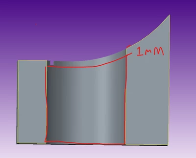

I am working on a design and I need to extrude 1 mm normal to a curved top surface. Reference simple part example. The top surface is not continuous. I think there's a way to offset an entire top surface down 1 mm and then cut up to that surface. How do I create that offset surface? Snapshot below is what I'd like to achieve

If you are extruding a solid up to the depth reference surface then use the depth option to extrude up to surface (quilt) set the selection filter to quilt and select it as the depth reference. It is the last option shown in the pic below with the red. Make sure your sketch will be completely inside the quilt boundaries (there are exceptions to this for some features but it is best to avoid going outside the lines so to speak). Be advised that if you change geometry that is a parent of the copied quilt depth reference and internal feature ids change that can cause failures of the extrusion.

Not continuous meaning not a smooth surface. The top level surface isn't a single surface. Think of a curved keypad for example. The top surface is the top of the buttons but they are broken up by the spaces to create the individual buttons.
I was able to create a copy of the entire top surface and then offset it by 1 mm. But how do I extrude from the bottom up to that offset surface?

You might be able to select all the surfaces, then do a Ctrl-C Ctrl-V (copy then paste) to create a quilt that is a copy of the surfaces "grouped together" in a quilt. Then do the extrude up to that quilt.

In many cases you can extrude up to a surface with holes in it and Creo will treat it a solid.
When the copying surface, the Options tab allows you to fill holes.
You can try extending the surface edges to cover the area needed.
If possible copy the surface in the tree before the surface is broken up.
