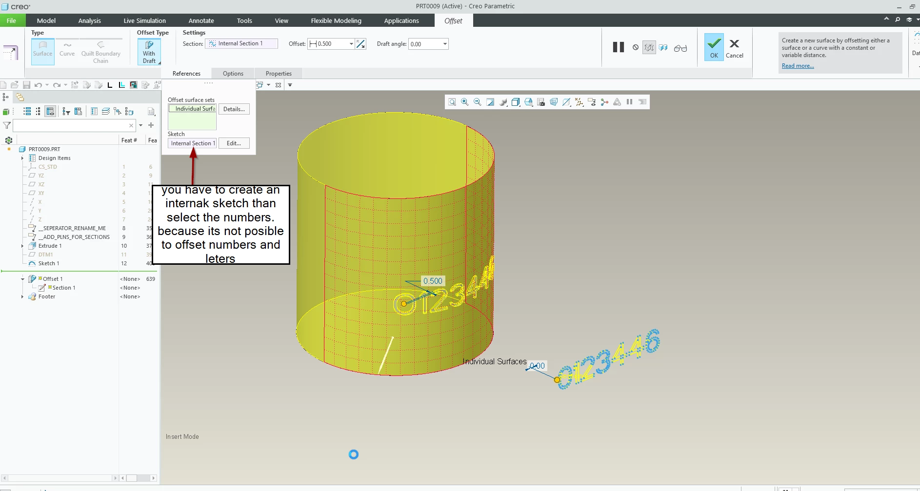

hello alle,
I'm so angry about the backwards development ot PTC creo wish involve the  extrude of sketch on a surface
this funktion was working great in the creo 4 version (https://www.youtube.com/watch?v=bOE9L8zE0qs&t=275s&ab_channel=CADHUT
after that they change it and its not possible to use an existing sketch but you have to redo the sketch as an internal one wish its not possible to add numbers to the sketch. if you want number you have to do them in normal sketch than reselect the curves in the internal sketch how an invective work is this.
I hope for PTC to learn from things that already works and stop breaking them while developing creo funktions.

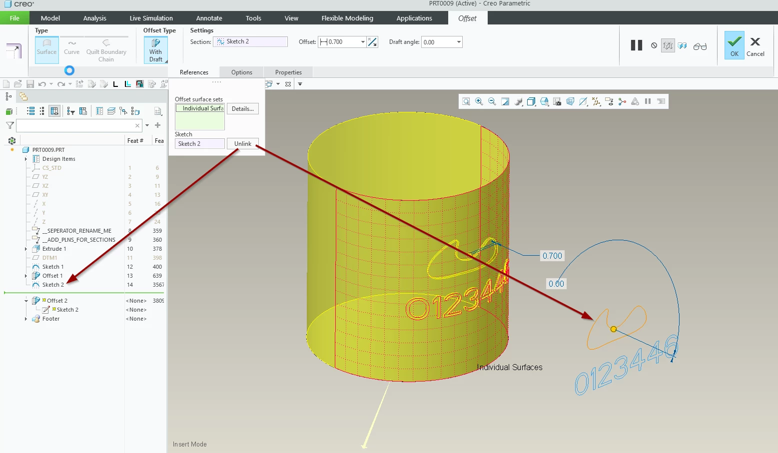

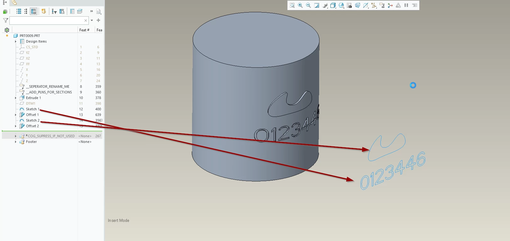

What version of creo are you using? It does work in Creo 8 at least flawlessly. The GUI is a bit different but it works the same.
Though I do wish you could reference a wraped sketch directly.

thanky for the reply,
I´m using now the 10.04 version.
I uploaded a test part that shows what i mean.
kind regards
