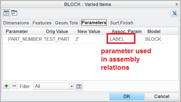

I can't open your file as it is Creo 4?, but having spent quite a bit of time trying to "automate" assemblies with relations that drive flexible components, I think you are maybe missing the use of component-level relations and adding the associated parameter to the varied items table of your flexible component?
See one of my replies in this thread as it has a demo assembly that has components labeled with sketched-text objects that change depending on assembly conditions.

I just learned something 🙂
I opened multi_position_demo.asm and explored it.
I was staring at why following component relation of 2nd component worked (it sets text inside LABEL feature)
LABEL=ITOS(POSITION) + "'"
After some time I asked Google ... creo flexible parameter assembly rels
and received answer in https://www.mcadcentral.com/threads/19587-Changing-flexible-params-with-assy-rels discussion.
