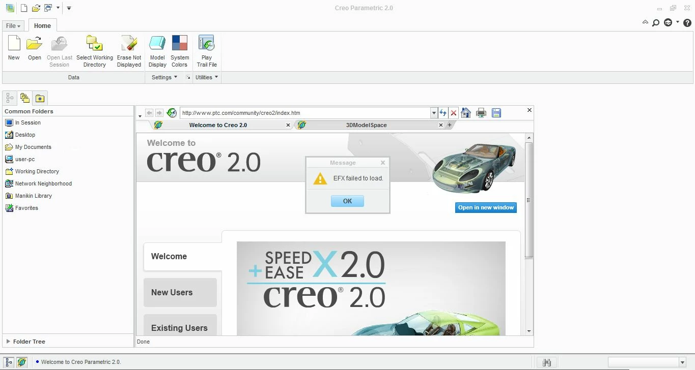

Failing to enable AFX feature
Framework doesnt work, afx shows its enabled but when i start the application again it shows "EFX failed to load" framework option doesnt turn up anywhere .please help me sort out this problem and suggest me so that i can work with framework il be thankfull if this problem gets solved by anyone

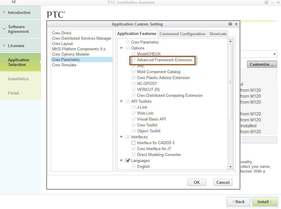

Make sure while installing Creo you checked Advance Framework to be installed and have the license for framework in Creo.
If it was not installed, you need to install this from installtion media.
