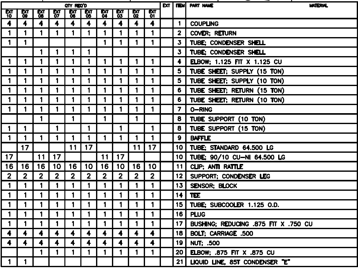

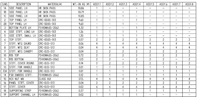

Hello everyone.
I have an interesting problem. I am trying to convert some assembly drawings to CREO Parametric. However, I'm not sure how to format a single table such that you can include multiple assemblies. See the picture below. It shows how different versions of the assembly contain different parts and and quantities. Is there a away to replicate the table shown in creo?
Help would be appreciated.
August 28, 2014
You would specify multiple quantity columns but it will depend on how you have things setup and there's the issue of not being able to use BOM balloons with multiple quantity columns.
