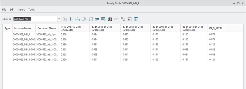

TL/DR: If you make a family table of dimensions varied from an inheritance feature, the column headings are funky - how to rename?
Follow me a bit ... Thought I had a brilliant idea.  We have two parts that are kind of similar.  Both of them have family tables.  Not similar enough that I want to throw everything into a single .prt with one big family table. But 90% of what's there is common.  So why not use inheritance to share the common geometries??

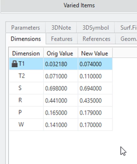

So I picked part "A" as the master part.  "A" has a family table.  Created a new "B" part by inheriting "A".  Added Varied items to the inheritance feature so I could suppress "A"'s features not needed in "B" and have some "B" dimensions different from "A".  So far, so good.
"B"'s new dimensions also need to be tabulated, so I added the dimensions to "B"'s family table.
Family table column headings make no sense.  In the inheritance feature's varied items, the dimension name shows as "P" (same as I renamed in "A"), but in the family table, it shows up as "IN_D_298:FID_2441 D298[2441]". Expected result: column heading in the family table editor would display "T1", "T2", "S", "R", "P", "W" like they do in varied items. See pictures.
If I drill into the the inheritance feature and edit dimensions, the dimension names show up as "T1", "T2", "S", "R", "P", "W".  So I can't change the column headings (dimension names) the "normal" way.
Work around is to create parameters in "B" with the right names, then use relations to change the varied items.  I might need to keep the silly column names to actually get the instances to regenerate with the right dimension values.  Surely there's an easier way.

The impossibility to rename headers of Family Table columns is a current limitation of Creo Parametric, effective whatever the version used. The headers are always supposed to show the identifiers, and they are populated in an hardcoded way (not drivable by any config.pro option).
Considering above limitation, I can nevertheless try to provide some guidance to gather in the Varied Items table to "good and relevant information" which can be observed later in the column(s headers od the family tables.
=> This can be done essentially thanks to Assoc.Param column, and helpful also the owner column.

February 7, 2022
Thanks for the video.  Unfortunately, the weird column headings don't provide mistake-proofing to the user that's maintaining the family table.  And the column headings aren't usable in a 2D repeat region in a drawing (e.g. to make a PDF / print of the tabulation).
