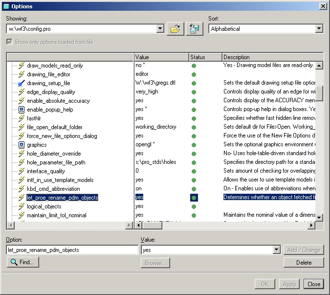

I have some parts sent to me from a vendor that I would like to rename
(so it's easier for me to identify). When I tried renaming I get this
error...
"Attempt to rename a PDM object
You may not rename an object that is managed by PDM from Pro/Engineer.
Perform the rename from with PDM."
Anyone have any idea how to get rid of this? These parts are obviously
outside their PDM system and will not be returned to them...
Tony
September 23, 2011
