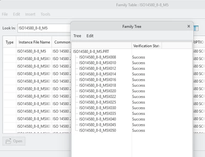

just a basic question: Are all FT instances successfully verified and then the generic model saved?
Mat16-PearlAuthor
Dec 12, 2025 12:56 PM UTC
Yes, they look all verified:
