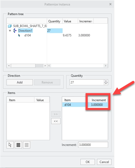

I used the family table patternize instance feature to make several shafts that change with their length. I am making a drawing and I want to pull in and show the incremental value that the patternize feature used. Is there a symbolic name (like &dxxx) for this particular dimension? I've looked several places and can't seem to find anything.

Chris3, thanks for the reply. I know how to get the dimension from the family table to show up in my drawing table but what I'm trying to get to show up is the number in the attached picture. As far as I can find, it doesn't have a name that will pull it in to the drawing.

If no one else here can help I would try opening up a ticket. I am not sure PTC has a variable that can be referenced for that number.
